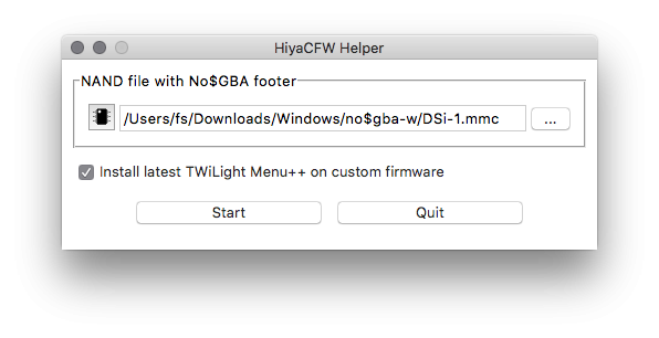

In order to make things easier for me, and because I don't have Windows, I edited the HiyaCFW Helper Python script by jerbear64 and LmN in order to add a graphical user interface to it.
What it does:
- Allows you to browse for your NAND backup, no need to place it at the same folder.
- Shows the option to choose the output destination, which should be a (preferably empty) FAT formatted SD card or any other folder.
- Downloads the latest HiyaCFW release and decompress it.
- Autodetects the console region from the NAND dump, downloads and decrypts its v512 launcher.
- Creates the patched 00000002.app and bootloader.nds for the custom firmware.
- Uses your platform's twltool (binaries for Linux and MacOS included) to decrypt the NAND.
- Mounts the decrypted NAND (OSFMount required for Windows) and extracts it to the chosen output destination.
- Installs the HiyaCFW and the patched files on the chosen output destination.
- (Optional) installs the latest release of TWiLightMenu++ (or any of the previous releases of it or DSiMenu++ or SRLoader placed at the same folder as the helper) on the chosen output destination.
NAND mode:
Clicking on the integrated circuit button will give you a NAND mode, where you can uninstall unlaunch or install its v1.4 stable release, remove the No$GBA footer or add it. Recommended only for those with a hardmod.
